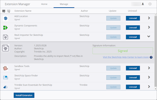

The SketchUp Extension Manager enables you to update, uninstall, or disable extensions
To update an extension in the Extension Manager, follow these steps:
  1. In SketchUp, select Extensions > Extension Manager. The Extension Manager window appears.
  2. Click the Manage tab at the top.
  3. Click the Update button next to the extension that you want to update. Or to install all the updates at once, select the extensions you want to update and click the Update option that appears at the very top of the column.

The Extension Manager enables you to see whether an extension is signed. If you have an unsigned extension, you can tell SketchUp whether you trust the file, which determines whether the extension can be enabled at startup. Follow these steps:
  1. Select Extensions > Extension Manager. The Extension Manager window appears.
  2. In the Extension Name column, you see whether an extension is signed. Click the right-pointing arrow to see an extension’s details, and you can view the extension’s signature information and designate an unsigned signature as trusted.
