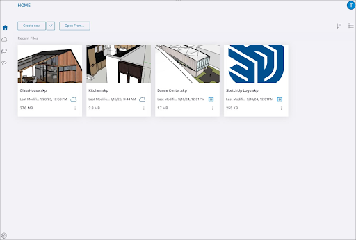

On the home screen, an icon designates a file’s status:
- Locally saved file –

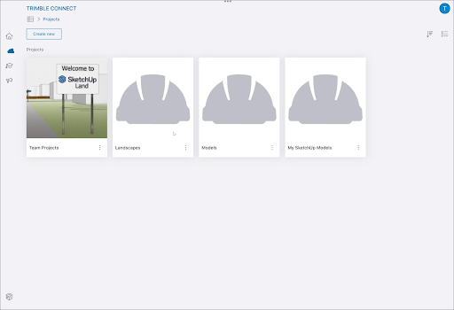

- Saved to Trimble Connect –
If you want to move a locally saved file to Trimble Connect, tap the menu icon (
) and select Publish to Connect. In the window that appears, choose the project you want to add the file to and tap Publish to Connect to save it.
You can access any file saved to a Trimble Connect project from the Trimble Connect tab on the Home screen.
