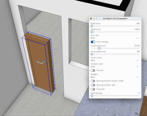

SketchUp
Similar to any other SketchUp component, Live Components can be configured by choosing Configure Live Component from the components context menu or double-clicking the component.
Due to the way Live Components work, it may take a little bit longer for the configuration panel to load.
To further adjust your component to best fit your model, you can use SketchUp’s Scale tool () to adjust your Live Components. SketchUp’s scale grips are not always locked to the bounds of the component to better identify exactly how you want to size it.
If you would like to adjust the way your Live Component looks, you can apply custom materials using the Paint Bucket tool (). Material capabilities include that ability to use materials not already in the component, and the ability to apply SketchUp’s photorealistic materials.
