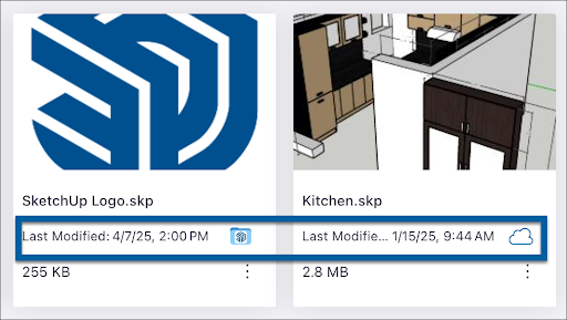

Recent Files
On the Home Screen, recent files saved locally appear with a folder (). Files saved to Trimble Connect appear with a cloud ().
When a model is stored locally you can open the menu () to access the following options:
